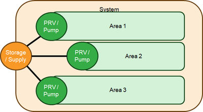

It sounds like this area contains a single "water system" subnetwork that has three "water pressure" subnetworks. The supply/storage that provide water to all three areas during normal operation will be subnetwork controllers for the water system tier. While the equipment that regulate each zone (pressure valves, pumps, etc) are exclusive to each area will be subnetwork controllers for the water pressure tier for each area. Here is a rough diagram I just put together:
