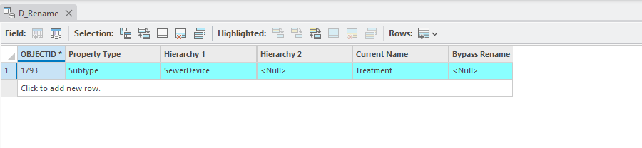

I was able to create the D_Rename  table. With ArcGIS Pro I opened the table to select the record I want to modify. Where do I add the new value "Treatment Plant". to replace "Treatment".?

Sorry, but I still do not understand how to rename the new field using the format "Rename_?????", in my case I want to rename an asset group "Treatment" to "Treatment Plant".  What will be the name of the new column  "Rename_...."
Please advise.
RobertKrisher
@SanchezNuñez Add a new column called something like "Rename_Foo" and put the value "Treatment Plant" in that column for the row that corresponds to "Treatment". When you deploy the asset package, you will see an option to rename using "Foo".
