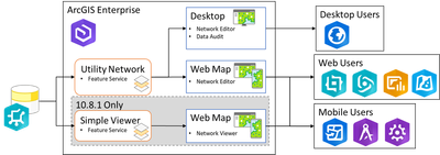

The first graphic in the article should help understand this better:
When you "publish a web layer" you are creating a feature service for the features in your enterprise geodatabase (this feature service SHOULD NOT include subtype group layers or any additional symbology). When you "publish a web map" you are taking a display where you have applied configuration (labels, symbology, etc) to those feature services and wish to share the resulting display with web/mobile users. There are situations where you can have multiple feature services, but you shouldn't have a separate service for each map (ne feature service should support many maps).
