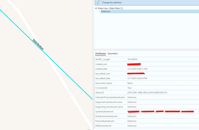

But during the process of building subnetwork, it turns out that the asset of water line is belong to more than one subnetwork. Is this a glitch or if there is something we didnt aware of?
Run subnetwork tracing of this system subnetwork A, B, C, D respectively all return the same coverage area.

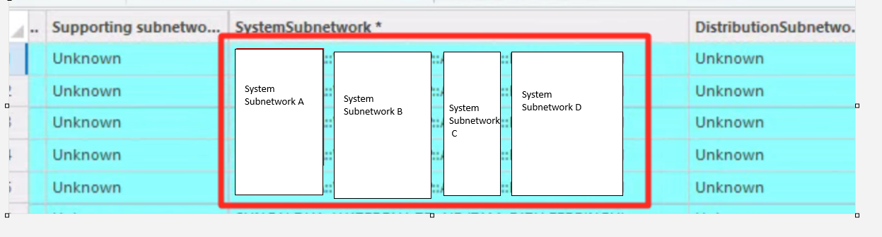

From the screenshot it looks like you are not using one of the utility network foundations, so it's for me to speculate what could be going on in your situation since I don't know how your data is configured.

The Water System Tier is configured with these parameters.
And we have only build system subnetwork for now and have little clue on why the subnetwork behave these way. As in some region, the subnetwork is overlapping but in other region, the subnetwork hit error 29 for overlapping.
First case seem not applicable to our case as i can see that the water line and other non-barrier feature are belong to 5 system subnetwork even it is not a barrier. For case two, I am not sure how to verify if this is the case, appreciate if you could share some thoughts on this. For context, we only performed "Assign Terminal Connections" for terminal devices and directly build the subnetwork due to certain reason.

In instances where the subnetwork controllers are separate by devices with directional terminal configuration, like in the screenshot above, you will end up with a line with multiple systems. I discuss an example of this in the cross-fed section of the subnetwork quality assurance tutorial.

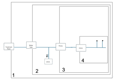

This is the tier where we’ve configured the subnetwork controller. Appreciate if you could have a look and share any insights or idea you might have?

Ok, looking at the diagram above a feature in the right-most DMA would have:
System: 1
Pressure: 3
DMA: 4

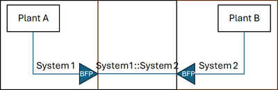

In order for the subnetwork names to be concatenated you would need something like the following:

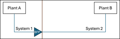

If there was only a single backflow preventer (or pump or some other directional device), then you would get an inconsistent subnetwork name because one of the system subnetwork controllers would be able to be connected to the other controller, and they have different names.
