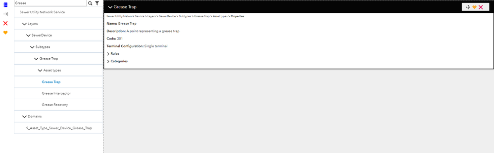

Hey John,
The most recent version of the Sewer Data Management for ArcGIS Enterprise solution includes Grease Traps, Grease Interceptors and Grease Recovery Devices in the Utility Network Data Model. You can find them in the SewerDevices layer in the Grease Trap Asset Group. Check out the Sewer Utility Network Data Dictionary here. Search for "Grease" in the search bar top left to return the relevant Asset Groups and Asset Types.

Thanks for your reply.  This helps a lot.  I'm building my network in an FGDB and I must be working off an older asset package.  I'll look into updating that.  Thanks again.
