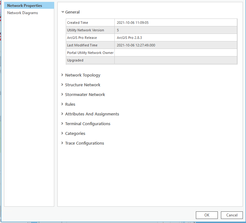

Hi. I'm trying to apply an asset package to an enterprise geodatabase and running into this error shown in the screenshot. I've checked both fields in each feature class, and they're both 64.  Not sure what is happening here. Capture.JPG

SMW_GIS
Thanks for your response. Really appreciate it. I went and  checked and it looks like my UN is in version 5 already.
