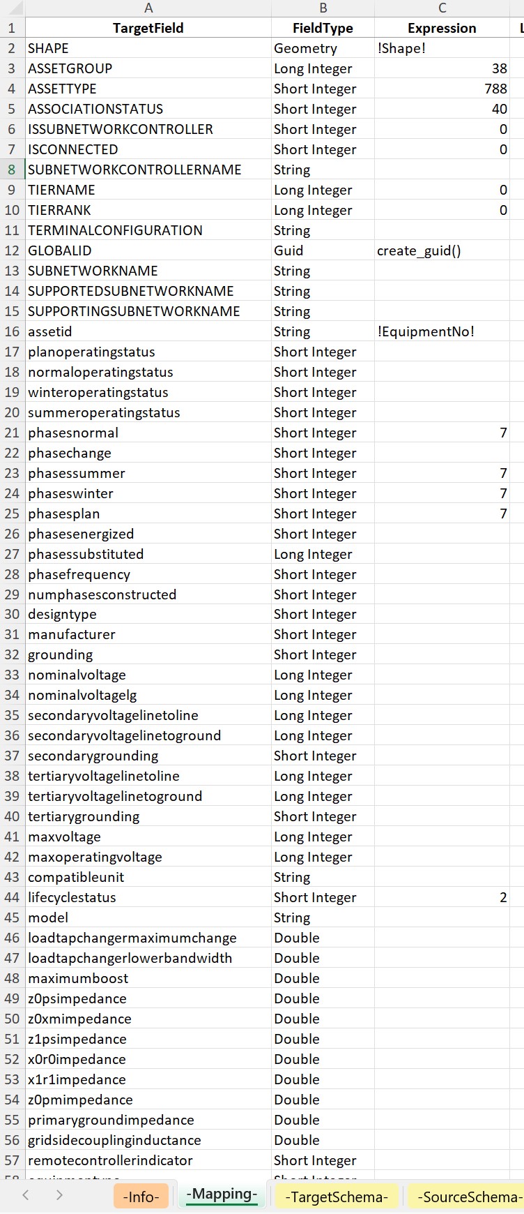

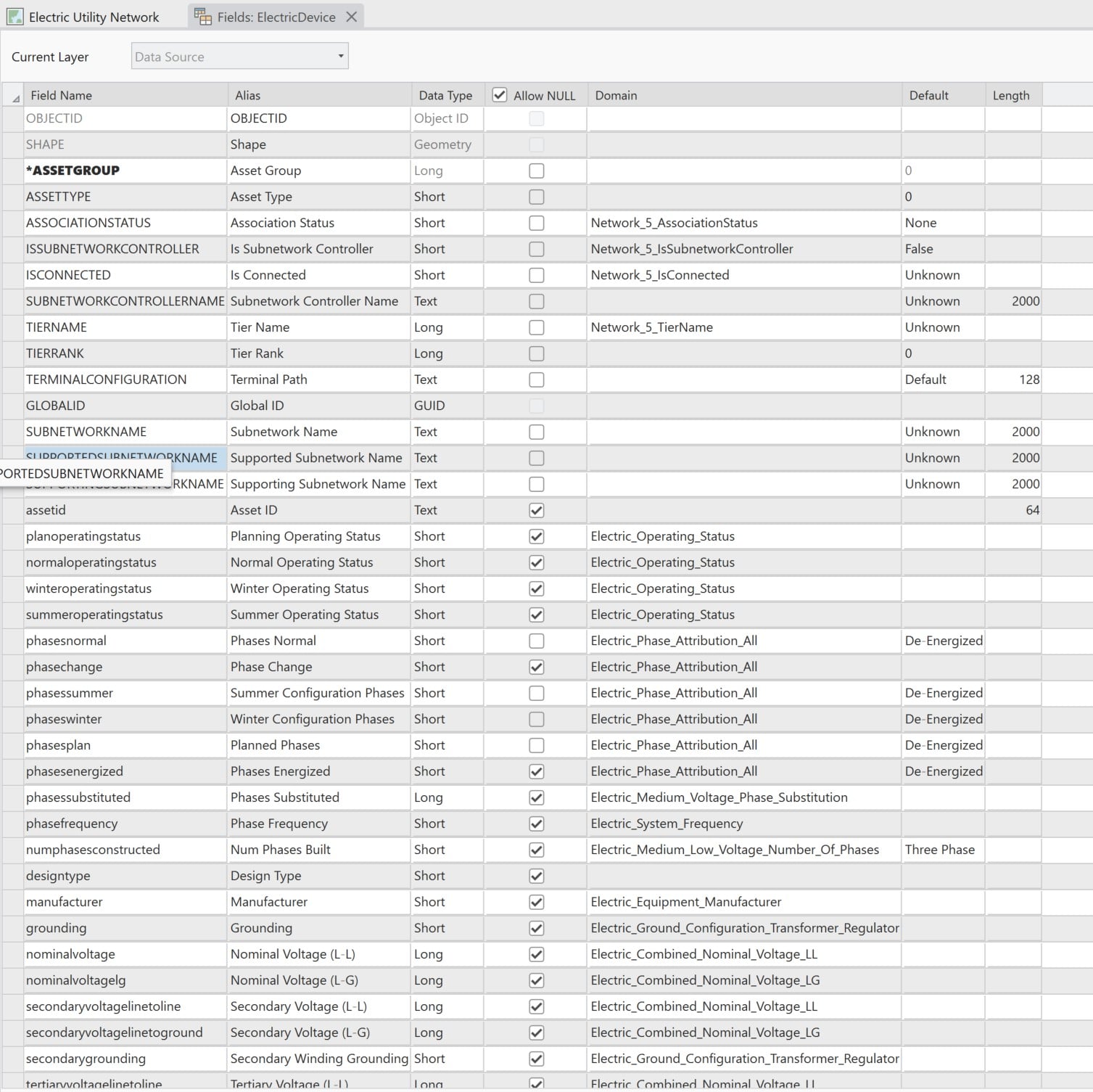

I keep running into this error message 160145: Field is Not Nullable.
I am using the Load data using workspace excel file
I am having trouble with mapping from a point feature class "Loads" to Electric Device feature class.
I have Checked all the fields that are not nullable, and I am almost 100% sure I have assigned values to them all unless I keep missing something. I also checked my source data and there is nothing null in my source, mapping calculated fields also says 100% filled factor.
I have attached photos below of my fields that don't allow nullable values in the target dataset and also a photo of the source dataset mapping.
I am just not sure why it keeps saying there is a null value in a not nullable field, when all the not nullable fields are being populated with values.
Maybe I need an extra set of eyes on this to help me see my error and what I am missing, also I did not populate the string categories but that has never mattered before all my other data loads worked with empty string columns and I tried filling those and it made no difference.

Also, I'd recommend not putting values in the system managed fields (associationstatus, subnetworkname, supportedsubnetworkname, supportingsubnetworkname, tiername, tierrank, isconnected, issubnetworkcontroller). You can also leave those other unused phase fields unmapped so they have the default (de-energized)
