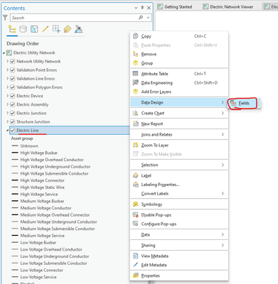

@mshanaghan - You could review the rules in Attribute Rules assigned to the layer.
Hopefully they have the key words "240V" or "offset" in the description or where the trigger is = Insert
The other way I thought this might happen is if you have a group template.
But I don't think it fits what you are describing.
The offset setting group template would trigger as soon as you finish drawing the geometry.
