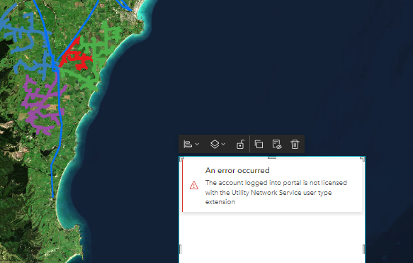

I have then tried publishing a map with the UN trace widget but it says -

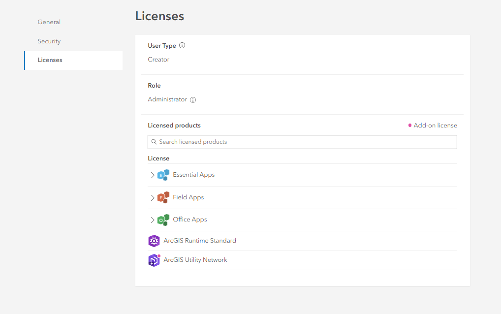

But clearly my user has the add-on license assigned.

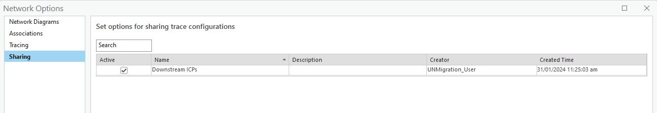

I have tested the trace it works in ArcPro and made sure its shared.
