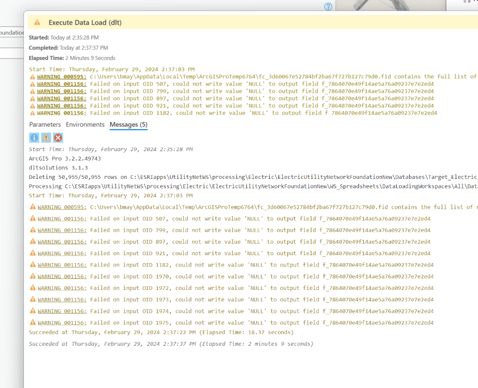

Execute Data Load Warning 001156: Could not write value 'NULL' to output field f_7864070e49f14ae5a76a09237e7e2ed4
3830
8
02-29-2024 11:48 AM
BryanMay531
Can anyone remind me how identify the field? :
there is somewhere to crossreference to a real field name but I can't find it today

@BryanMay531 I just noticed that you're running the 3.1 version of the data loading tools using a 3.2 version of ArcGIS Pro. The data loading tools were incorporated into the core geoprocessing framework of ArcGIS Pro in 3.2, so I'd recommend you try this again using the Data Management > Data Loading toolbox. Even if it doesn't succeed, you should see some more informative error messages.

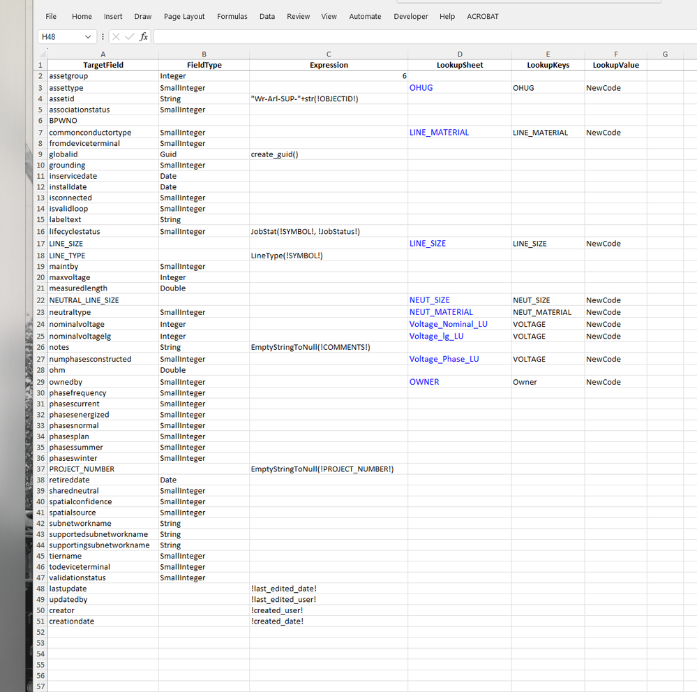

BryanMay531
I'mjust trying to figure out what that temp field name relates to in my data.  Here is the  mapping page in my WS
RobertKrisher
@BryanMay531 I'm not sure actually, but my guess would be one of the fields that is using the EmptyStringtoNull method. Can you post the snippet for that method? I suspect it is returning something other than the Python representation of null (None).
BryanMay531
Sure.  I attached the script.
thanks

Each time I wrote a custom python function in the base.py script and referenced this function in the Mapping sheet, I had this behavior. The name of the field in error logs is not the original name, but something like f_7864070e49f14ae5a76a09237e7e2ed4 which make it really difficult to debug
