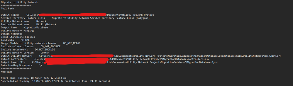

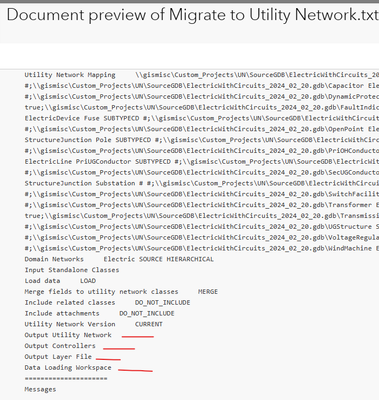

@BrandoCrozier - I have not seen this error and the tool seems to work fine when we used it.
I think the issue might be Output Folder path.
Looking at the text file attached I think the issue is that couple of parameters are left blank when the tool runs. It could be that that the tool is having trouble setting these parameters as the output folder defined in your code is a UNC path.
Below is a snapshot of the what it looks on my end.
You can see that the Output Utility Network is a full path (in your its blank)
I think the code cannot understand the UNC path \\gismisc\Custom_Projects\UN\Prototypes\UN_Simple_Migration_001
Could you try using an absolute path?
