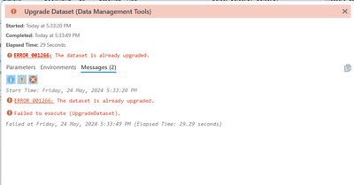

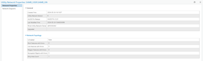

I'm working with Pro 3.3 and AGE 11.2 and noticed that when running the Upgrade Dataset in 3.3, it says that the dataset is already upgraded, but the version is still 6. Do have any solutions?

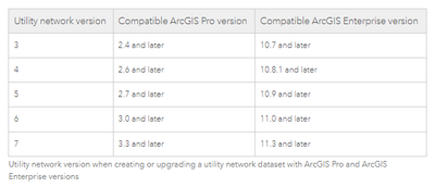

You referenced you're working with ArcGIS Pro 3.3 and Enterprise 11.2.  When working within an enterprise deployment, the version of ArcGIS Pro and the portal's federated server are used to determine the compatible Utility Network Version.
 UNv7 is supported starting with Enterprise 11.3 so this combination would create a UNv6.   Being that you are already at this version this is why you are seeing the "dataset is already upgraded".
https://pro.arcgis.com/en/pro-app/latest/help/data/utility-network/utility-network-compatibility.htm

It says the geodatabase is already at the current release and cannot be upgraded.

I'm getting this same message using ArcGIS Pro 3.3.6 with a Geodatabase Upgraded to 11.3
