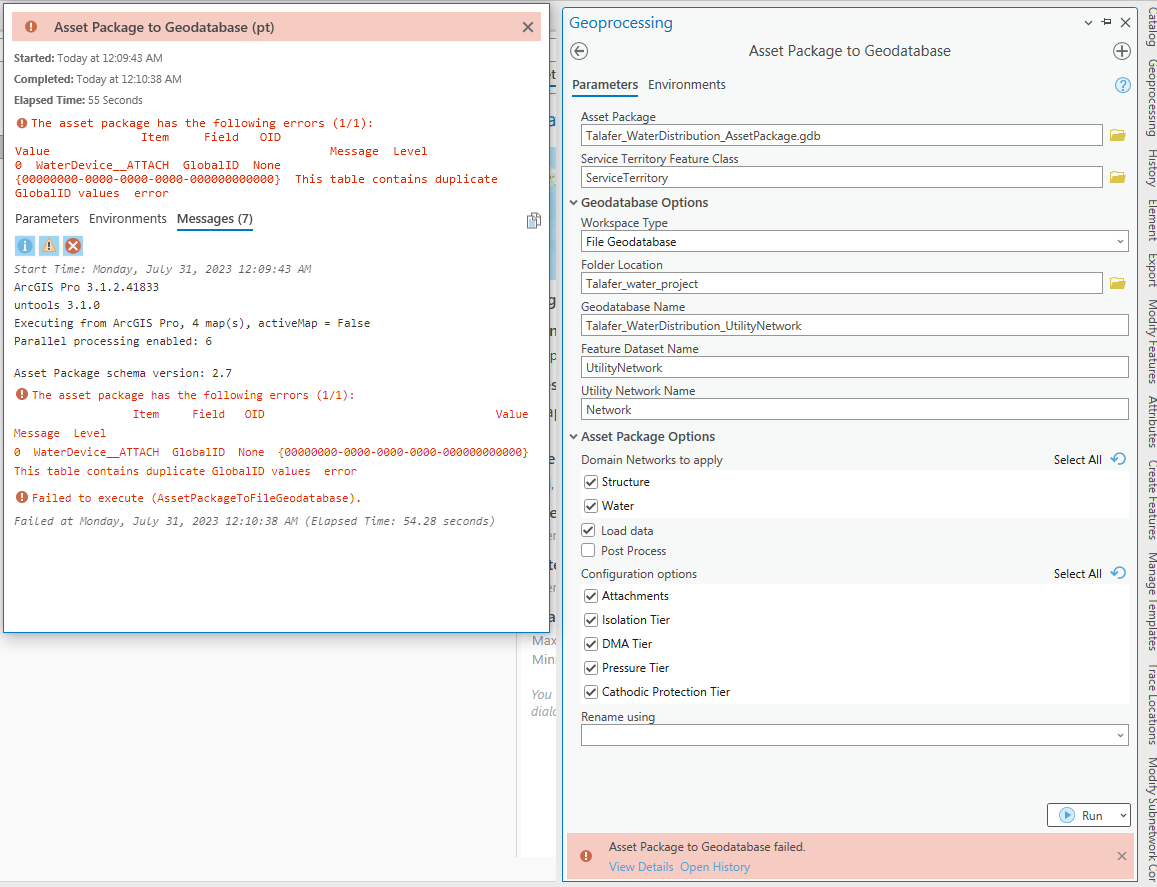

but when I tried to stage the utility network via the "Assets package to Geodatabase" it showed the error below in the screenshot.
can anyone advise what the possible mistake was, I checked the database and I didn't find such a Global ID value

The asset package has the following errors (1/1):
Item Field OID Value Message Level
0 WaterDevice__ATTACH GlobalID None {00000000-0000-0000-0000-000000000000} This table contains duplicate GlobalID values error
Failed to execute (AssetPackageToFileGeodatabase).
Failed at Monday, July 31, 2023 10:17:27 AM (Elapsed Time: 57.17 seconds)

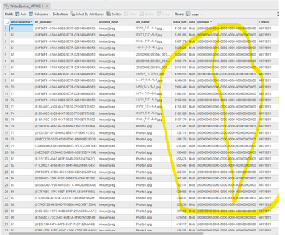

the error showed in WaterDevice__ATTACH GlobalID, which are empty relation classes in a geodatabase that include most of the attribute rules. as I understand.

This table:
