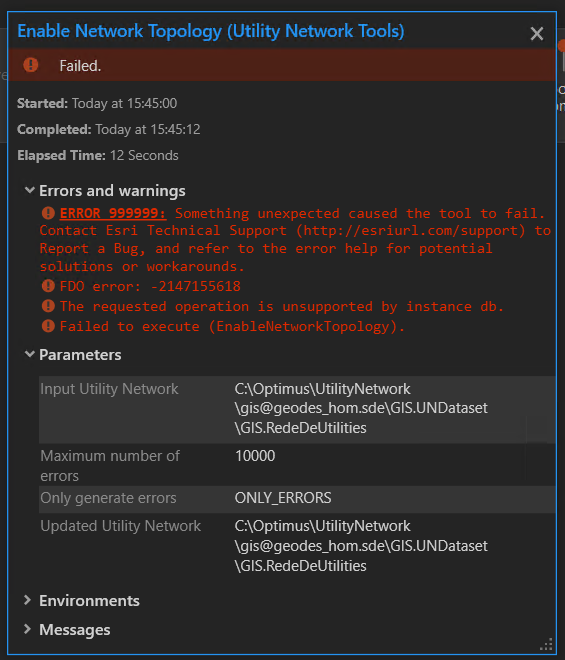

I am trying to configure a utility Network on a Oracle 19c db.
After I create and configure a Utility Network and go to "Enable Topology" the error "The requested operation is unsupported by instance db" occurs, with FDO error: -2147155618.
I do not receive this error on SQL Server db.
Can anyone help me with this?
UNError.pngUNError.png.

The Utility Network was configured manually. I created the Utility Network on SQL Server, export the Asset Package and tried to import on Oracle Geodatabase. When it fail I created a new Utility Network with the same configuration of the one of SQL Developer and at the time of Enabling Network Topology it fails.
The problem occurs when the feature classes is with data. When I try with no data, the tool execution succed. But when I try to validade topology, another error appears. A generic error.
