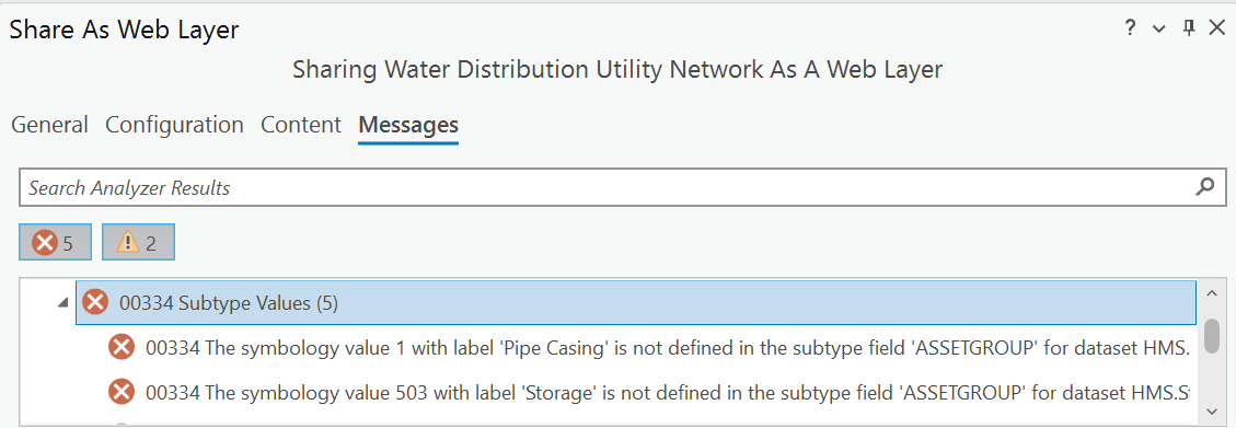

I am trying to publish my water utility network into the enterprise, i tried to run the analyze and i ended up with this error

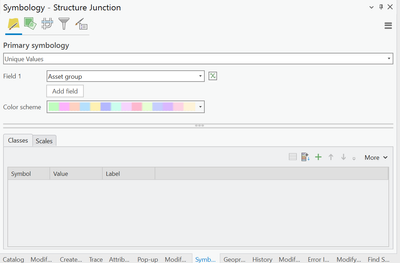

In the symbology i removed everything, because my structure junction does not have any attributes. No matter what i am doing i end up getting this error, how to solve this?

Please post an image of the symbology properties for the layers in question.
Angiex__1
so i have removed all the existing symbology from the structure junction since they dont have any influence in the network and also my structure junction does not have attributes.

Expand your TOC and post a picture of that
Angiex__1
I have restarted the device, and the symbology worked.
