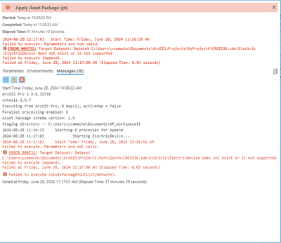

YulissaCamacho
Sure:
Apply Asset Package
Parameters
Asset Package C:\Users\ycamacho\Documents\UtilityNetworkCG.gdb
Domain Networks to apply Structure;Electric
Input Utility Network C:\Users\ycamacho\Documents\ArcGIS\Projects\MyProject4\CRGIS36.sde\coopegis_completa_un5.utility.Electric\coopegis_completa_un5.utility.UtilityNetworkCG
Load data INCLUDE_DATA
Calculate Spatial Index and Analyze ANALYZE
Output Utility Network
Configurations to apply
Rename using
Post Process NO_POST_PROCESS
Messages
Start Time: Friday, June 28, 2024 10:39:23 AM
ArcGIS Pro 2.9.6.32739
untools 2.9.7
Executing from ArcGIS Pro, 0 map(s), activeMap = False
Parallel processing enabled: 6
Asset Package schema version: 2.9
Staging directory -- C:\Users\ycamacho\Documents\AP_Workspace15
2024-06-28 11:16:33 Starting 6 processes for Append
2024-06-28 11:17:03 Starting ElectricDevice...
2024-06-28 11:17:03 Start Time: Friday, June 28, 2024 11:16:59 AM
Failed to execute. Parameters are not valid.
ERROR 000732: Target Dataset: Dataset C:\Users\ycamacho\Documents\ArcGIS\Projects\MyProject4\CRGIS36.sde\Electric\ElectricDevice does not exist or is not supported
Failed to execute (Append).
Failed at Friday, June 28, 2024 11:17:00 AM (Elapsed Time: 0.03 seconds)
Failed to execute (AssetPackageToUtilityNetwork).
Failed at Friday, June 28, 2024 11:17:03 AM (Elapsed Time: 37 minutes 39 seconds)
