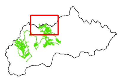

ArcGIS Pro 2.9.4 and ArcGIS Enterprise 10.9.1
Question: I have a question about Utility Network, I am not able to edit my Service Territory after it is published, is this operation not allowed? For example, If there is expansion of operations, how do I increase my Service Territory?

Hey @MatheusSparapani ,
Modifying your service territory is not supported at this time.  Your best bet is to take a large area (larger than the extent of your service territory) and use that as a service territory at the asset package level.
This is documented by ESRI here:  Here .  See "Network modifications"
Hope that helps.
