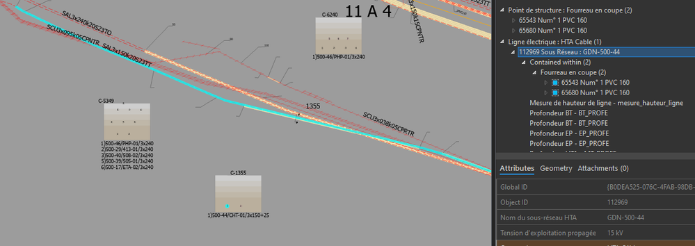

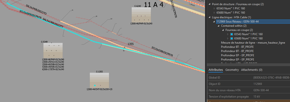

Hello,
I have many errors in ArcGIS Server logs like :
UtilityNetworkQuery::get_Containers : edge has invalid containers, gdbname.username.ElectricLine({B0DEA525-076C-4FAB-98DB-6FF991E49004})
But looking at the feature in ArcGIS Pro, there is no error related to containment association (no dirty areas, no error in the attribute pane or in the modify association pane...)
The features are electric lines (cables) that are contained into structure points (cross-sections of ducts)
Do you what could cause these logs ?

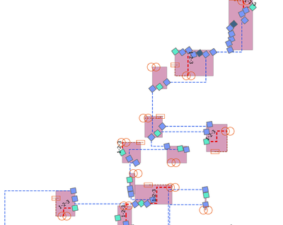

Def get the issue logged.  One note, if a line is contained in a point.  In diagram space, that line is collapse and with be completely in that container.  Just something to consider.  An attachment point on the line that is contained in that Structure Junction might be a better option if you are going to use diagrams.
PierreloupDucroix
MVP Regular Contributor
I do use system diagrams on these subnetworks, but line appear correctly.
Maybe because I do not show the structure points in the diagrams
