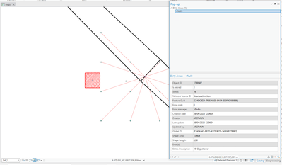

I have more than 1000 poles flagged with dirty areas that I cannot clear. The characteristics of these dirty areas are unusual:
  • The ErrorCode is 0 in the Dirty Areas table
  • The ErrorMessage field is empty / null
  • These dirty areas do not appear in the Error Inspector pane
  • Despite not showing up as errors in the Error Inspector, they are preventing the Update Subnetwork operation from running successfully

RobertKrisher
I'm glad you were able to figure it out! The key to understanding what was going on was the Status attribute. Object Error means there's an error with an object associated with the feature (or with one of the associations on the object).
