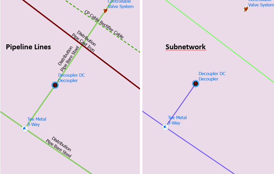

Hi,
I'm using the Gas and Pipeline Referencing Utility Network Foundation v.2.1 to model parts of a gas utility.
I'm trying to determine subnetworks in the Pressure Tier. The controllers (regulators) switch from high to low pressure correctly, but when I update the subnetwork with the geoprocessing tool the flow is "blocked" by the Pipeline Device "Decoupler".
The Decoupler is topologically connected to the pipes and is listed as a valid device in the networks options for the pressure tier. The Lifecycle status is set to In Service. I tried changing the Decoupler from DC to AC, still doesn't work.
I need a Decoupler because I need a point that refences a stop in the flow of current.
Am I missing something?
Thank you in advance,
Lorenzo
MikeMillerGIS
Esri Frequent Contributor
A Decoupler has a category of CP Only.  I would suggest removing this category
MikeMillerGIS
lorenzoz
Thank you Mike for you answer! I will try unissign the category
Lorenzo
