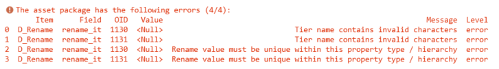

Hi all,
I'm trying to apply a new language to my Sewer data.
The tool Asset Package To Geodatabase works perfectly in english and if I select one of the predefined languages in the D_Rename table, but it returns an error if I select my custom field "Italian".
The error occurs at the end of the process: the UN database is created and correctly translated, but it is empty.
The error occurs always at Tier rows:
  • if I translate the current Tier names in Italian the error message is:
  • if I leave the Italian Tier names as <Null> the error message is:
I don't understand what's happening, and also why (see case 2) if I run the tool using Japanese (with the first two tiers NULL), for example, everything works fine but if I run the tool using Italian (with the first two tiers NULL) the tool stops returning the above mentioned error.
I'm currently using ArcGIS Pro 3.0 - UN vers. 6 (but also tested with ArcGIS 2.9.4 - UN vers. 5).
Please, any idea?? Thanks

You entered the string of "<Null>" for these entries.  They need to be be null.
