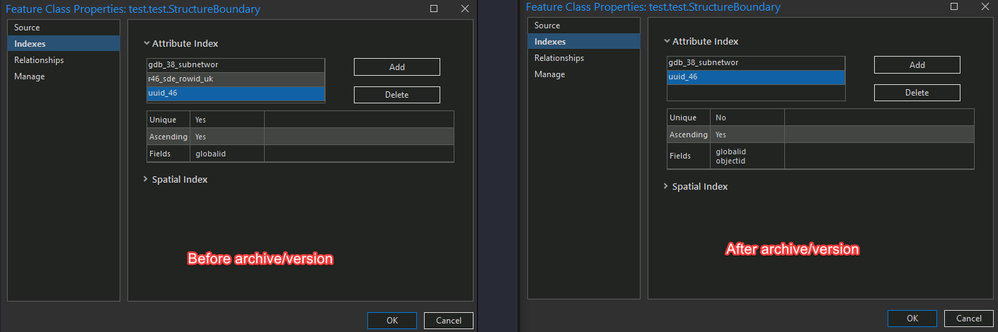

After creating a Utility Network in an enterprise geodatabase, I noticed that an index had been created on both globalId and objectID fields, and that this index was not unique.
non-unique index in SDEnon-unique index in SDE
When loading data into feature classes, the "Preserve globalId" option generates error 003340.
I thought that, by design, any index on the globalID field should be unique. Could this be related to the archiving of the feature class? Is there a restriction on adding a unique identifier to this field?
For example, in a new UN created in a mobile geodatabase, there are two different unique indexes on the GID and OID fields.
Unique idx in mobile gdbUnique idx in mobile gdb

After further testing, I'm now certain that enabling branch versioning and archiving is causing the incorrect index in the geodatabase:
I just tested in a new geodatabase, with a new schema and a new UN. Right after creating the UN (using the Stage Utility Network tool), the FCs have two unique indexes on the GID and the OID. But as soon as I enable branch versioning and archiving, the OID index is removed, and the other index now contain GID and OID fields and is no longer unique.
Tested with Pro 3.3.7 / AGE 11.3 but also seen with Pro 3.5.5 / AGE 11.5.
I am logging a case.

After several exchanges with Esri France support, it appears that the described behavior (non-unique index on two fields in a UN dataset) is indeed expected.
An internal Esri article, which I do not have access to, states:
Description:
When using the Append tool in ArcGIS Pro with the Preserve GlobalIDs environment setting set to true, the tool fails to function successfully and produces the following error:
ERROR 003340: The target dataset must have a GlobalID field with a unique index in order to use the Preserve GlobalIDs geoprocessing environment setting.
Cause:
This issue can occur when users attempt to run the Append tool on a dataset that is registered as branch versioned, such as a utility network. Datasets registered as branch versionned cannot have a unique index.
The only solution seems to be to use Python, or the method mentioned earlier: Optimize performance + globalId field mapping
