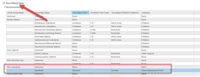

You can see what the asset type's current association role is by opening the tool or looking at the network properties (choose the show default values option to make it clearer). The association role of the handhole in the utility network foundation is structure.
