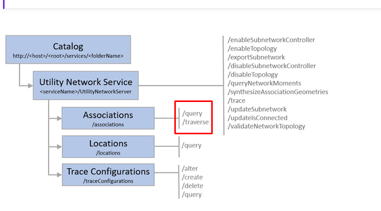

I am not quite familiar with Rest API but would like to know if there is any way to update the Junction Junction Association via Rest API? We want to create JJ Association between customer meter in water device and sub customer meter in water junction object via Rest API.
We came across these article, but seem that it only support query and traverse >>https://developers.arcgis.com/rest/services-reference/enterprise/associations-utility-network-server...?
>>https://developers.arcgis.com/rest/services-reference/enterprise/utility-network-service/

@AmberY I believe you can do this via the rest api. You would use the ApplyEdits operation to add/modify associations.

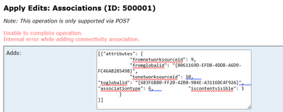

I am trying to pass the JSON in REST end and getting this error:
Same error i am getting in my script as well. Can you help?
@RishabhRaj29 - The "iscontentvisible" parameter isn't really valid for this type of connectivity.
I would suggest removing it.
The next thing to check is if you have rules that allow this connectivity and that if terminals need to be defined as well.
Not off-hand.
Have you tried the suggestion I made above? Create an association in Pro between the same two features and capture the applyEdits call with fiddler. How does it compare to the call that you are making manually?
