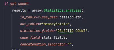

@BrettRosso Can you check the name of the ObjectID field on Long_Peak_District_Water_Lines?
Looking at the code, we are incorrectly assuming all classes have an ObjectID field called ObjectID:
