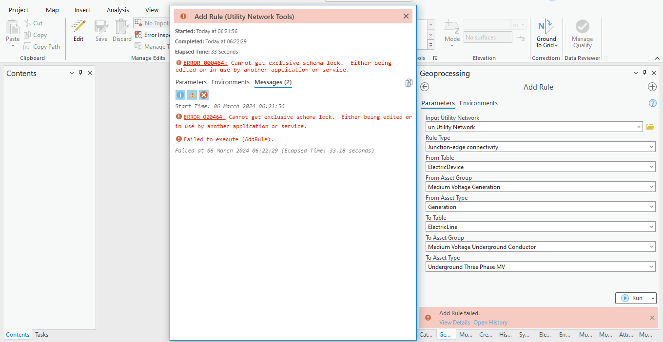

I am trying to migrate a Geometric Network dataset to Utility Network. I got errors 36,9 in the dirty area. I had to Add a new Rule to enable my Junction Edge Connectivity.
I am working with a local gdb. NOT AN ENTERPRISE GEODATABASE.
I am the only user accessing the Utility Network.
Steps followed in this sequence:
1. Stop Edits
2. Close all active maps
3. Disable Topology
4. Add Rule
ERROR 000464: Cannot get exclusive schema lock. Either being edited or in use by another application or service.
What could be causing the schema lock. Or am I doing something wrong.
