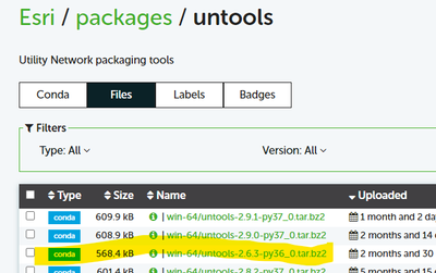

You should be on 2.6.3
if not, you can install the update through the python package manager or using the conda command line
Open Python Command Prompt
conda install untools=2.6.3
