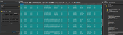

Here are the four rules available in the Electric Expanded Asset package March 2026 version (latest download on Solutions site)

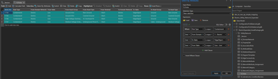

Here is a snippet of the same query on B_Rules in an asset package that was downloaded in 2025.  I am mostly interested in the MV OH and UG rules as my original builds did not error on the associations because these rules existed.
Here is the version of the older ap:

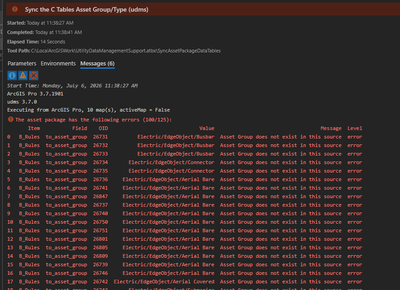

When I try to sync c_ tables with the rules copied from the old package to the new, I get this error:
So looks like the asset groups changed, for example, from Aerial Bare to Cable - Aerial Bare and the rules didn't get updated.
