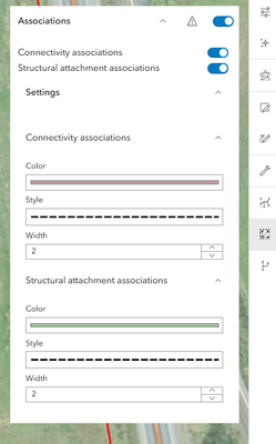

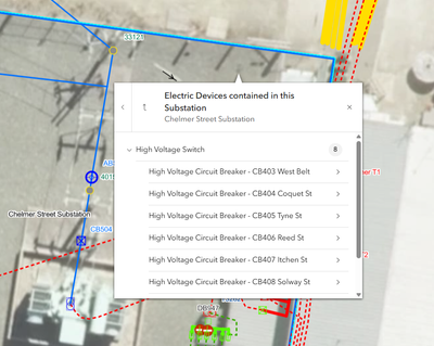

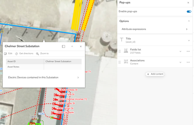

The Containment Associations cannot be "visualized" but they can be add the to pop-ups.
There is a associations element you can add to the pop-up.
For connectivity and structural associations - you can do this in ArcGIS pro and Mapviewer but I haven't found a setting for this in ExB
