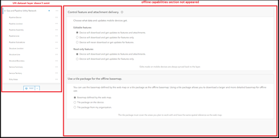

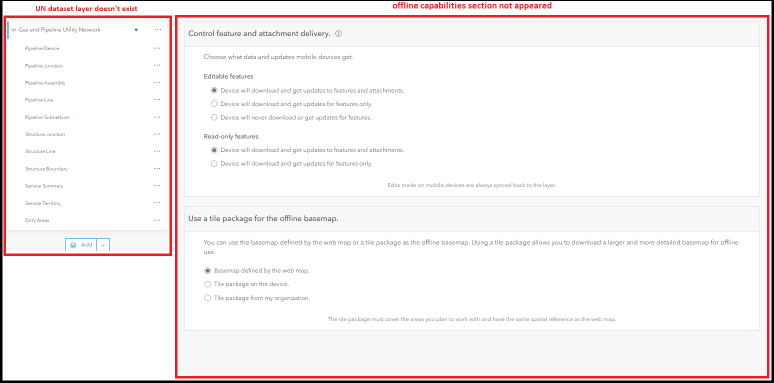

According to Esri's workflow, after publishing the UN service with sync enabled, I created a Web Map and added the service to it. Following that, I went to Web Map settings, enabled offline editing, accessed the advanced options, and cannot found offline capabilities, which include three options for UN services (Edit, Trace, Simple).

    2. Using the Feature Access URL (REST URL) from ArcGIS Server Manager displayed all layers in the Web Map but lacked the UN dataset layer (the Utility Network Dataset Layer was missing). Additionally, the offline capabilities section in doesn't exist, as shown below.

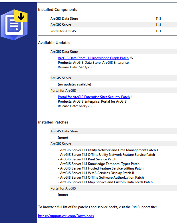

2- ArcGIS Enterprise 11.1 (with required patches) as follows:

Hi @DasheEbra:
As a first consideration, it's worth noting that certain types of associations may not be supported for offline edits.
Regarding the 'Offline editing' section in the Advanced Options, please check the following:
  1. Confirm that the user has the appropriate User type and Extension to perform offline edits & map settings.
  2. Ensure that you have followed the instructions outlined in the blog.
If the issue persists, it may be beneficial to provide additional details or steps for further troubleshooting.

@DasheEbra ,
Have you edited the config.js file on your Portal machine has documented in this blog post (in the section titled "How to configure the utility network's offline capability")?
