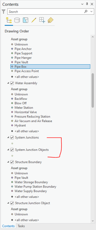

Is there a way to show System Junctions without having to run a Network Diagram? In our GN we had the system junctions point layer "Net_Juctions" for QA/QC to show areas where two pipes meet but no device/fitting is present. I did find when you run a network diagram you can see the System Junctions. Is there a way to view System Junctions outside of running a Network Diagram? Is this a "hidden" layer similar to the Associations table?

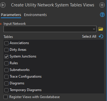

Hello,
you can use the "Create UN System Tables Views" from the UDMS Toolbox
https://github.com/Esri/Utility-Data-Management-Support-Tools

Hello,

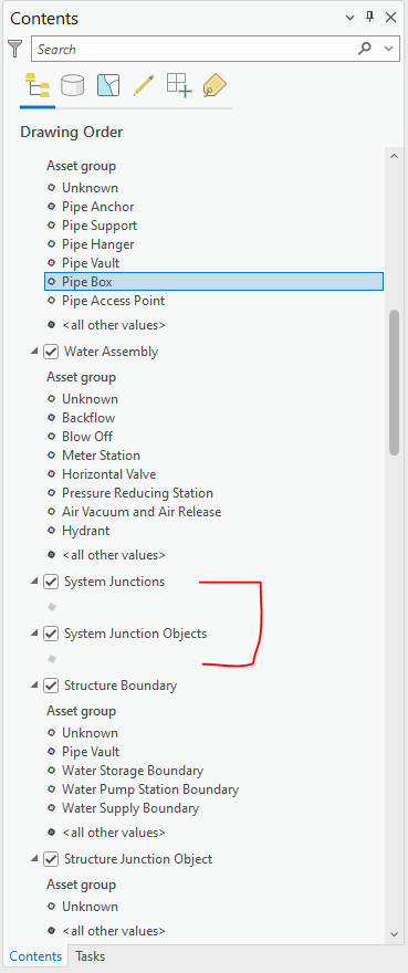

rlyding
excellent thank you
