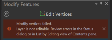

I am making some minor vertice updates to electric lines from a UN feature service in Pro 2.6.7 and then running Update Subnetwork on a specific Subnetwork Name to ensure end-to-end connectivity. However, after running the tool if I want to move on to the next subnetwork to make edits I am getting the following error:
Modify vertices failed. Layer is not editable. Review errors in the Status dialog or in List by Editing view of Contents pane.

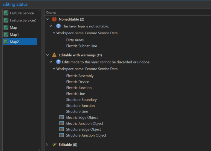

Going to the Status dialog it mentions that Dirty Areas and Electric Subnet Line are noneditable, and all other layers are editable with warnings (using enterprise geodatabase).
