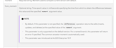

@VenkataKondepati has the right idea. You can retrieve the differences directly from the default version for any two arbitrary moments in time. This ability was added in 10.9 when we introduced the fromMoment parameter (Differences | ArcGIS REST APIs | Esri Developer).

Thanks @VenkataKondepati and @RobertKrisher for taking time to answer my question. I agree that the idea of Venkata was right, but as Robert rightly pointed it is better to use the ArcGIS API for Python which I was expecting also. To summarize, the differences method in the version class in ArcGIS API for Python can be used to achieve the required output. They key is to get the SDE.Default version and pass the moment (this is basically to moment) and from_moment parameter.
