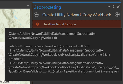

I added in the toolbox you provided the link to, but it gives me this error. Do I have to remove the existing toolbox first?

When you replaced the toolbox, did you restart pro?  Did you delete the old one?
TanyaWright1
Hi Mike,
After restarting everything and deleting out the old toolbox I was able to successfully run the tool using the new toolbox. Thank you!
