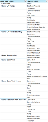

Can anyone point me to any useful resources that illustrates examples of Utility Network Containments in a Wastewater Infrastructure system. For example a wastewater treatment plant or a wastewater pumping station. Showing a relationship with an above ground asset register would also be useful.
Same idea as this but for a wastewater system:

If you already have an Esri geodatabase or pre-defined relationships between different assets and/or structures, then you can choose to represent many of these relationships using associations in your utility network.
If you don't already have a model in mind, I recommend you download the Sewer Utility Network Foundation and look at the containment rules provided in their model, along with the sample data included in the foundation. Read the Introducing Utility Network Foundation article to learn more about these models and how to access them.
Below is a graphic I put together using excel that shows the containment associations included in the Sewer model:
