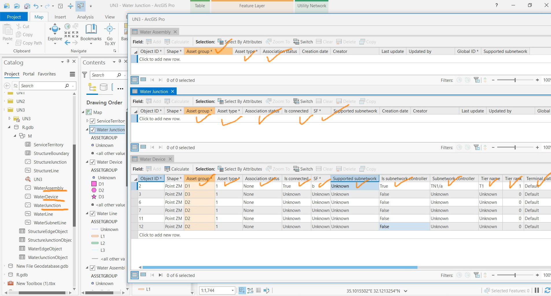

As 3 point layers (assembly, device, junction) and other 2 line layers (line, subnetline) are created by default for a utility network, I couldn’t figure out where to store point\line elements.
For example, based on what we choose to store a particular point layer either on assembly, device, or junction?
