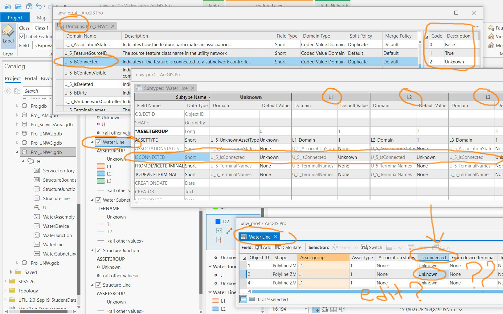

For example, in the screenshot below, the “isconnected” field (of the “water line” UN feature class) that is connected to the “u_5_isconnected” domain is not editable.
What could be the issue here?

That field is managed by the system. In this case, it is updated by Update Subnetwork and Update Is Connected.
Domain networks—ArcGIS Pro | Documentation

Nothing happens as the “update is connected” tool is performed. The “is connected” field is not affected.
Jamal Numan
PaulLeBlanc1
You must have a subnetwork controller. Update Is Connected—Utility Network Toolbox | Documentation
This attribute helps identify isolated features by maintaining whether a feature has connectivity to a subnetwork controller.
