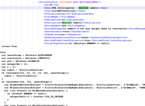

In the ap_workspace folder, is there any reported in the GP log?  Can you verify the AR is in the xml file in the apworkspace folder?

But yes, you can see here that the AR is in the AP_UN.xml file :

If they are in the file, we are sending them to the GDB. If the gdb is failing to add them and not report an error, that is an issue.  Any chance we can get the entire AP Workspace?
