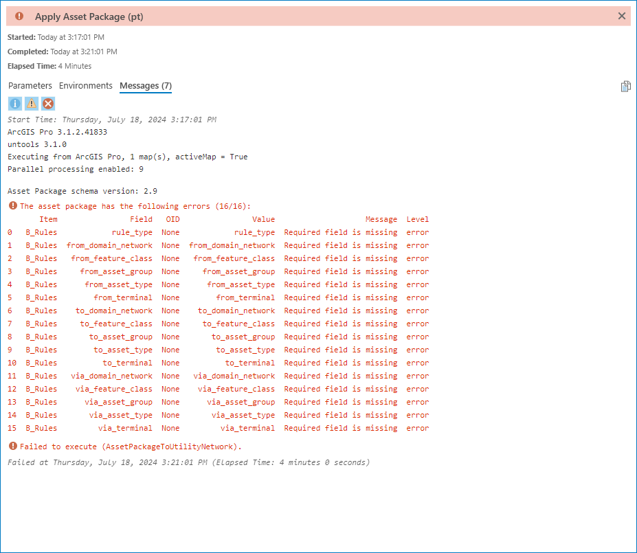

I was able previously to stage a UN and apply an asset package, but my first attempt didn't include all the fields I want to carry over from our existing geometric network.  So I created a new asset gdb that includes all the UN-required fields plus my appended fields and then tried to apply the new asset package to a new staged utility network gdb. I'm getting the errors shown below.  Since the b_rules table is not user-created, I'm thinking that I'm missing an attribute in one of the asset feature classes, but I've compared the asset package that worked with the new one and I can't find the discrepancy.  Any ideas on why this error would occur?  Thanks.

PaulLeBlanc1
https://doc.arcgis.com/en/arcgis-solutions/latest/tool-reference/utility-network-package/upgrade-ass...
This will add any missing fields to the asset package tables (A, B, C, etc).

PaulLeBlanc1
You would just run the tool in the lowest version of Pro that you want to support (presumably 3.1.x).
SusanONeill1
That did get me past the error, but I had a few hurdles after that.  It appears that when I added fields to the FME script, somehow the output no longer had M and Z values enabled.  So it looks like if / when I have to rerun the script I have a few errors I need to fix first.  Thanks for your assistance.
