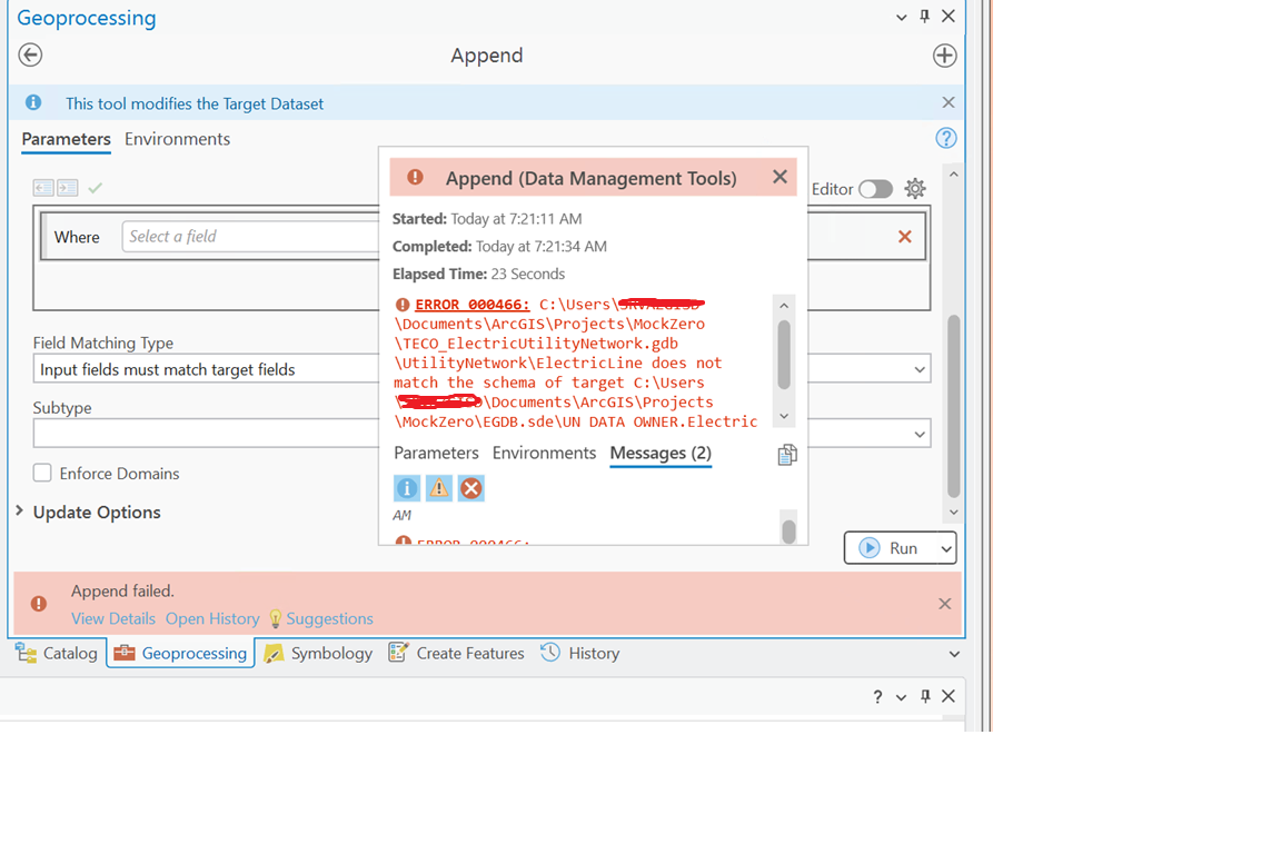

When we try to manually run the append tool , Its failing with Schema difference error for the field match type of Schema must match , But If run the append tool with 'USe the Field map to match'option , there we dont find any differences the append tool succeeds

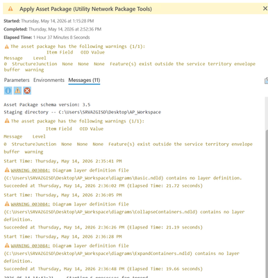

When we checked the logs for Apply AP- don't find anything related to append . Can you please share your view on this?

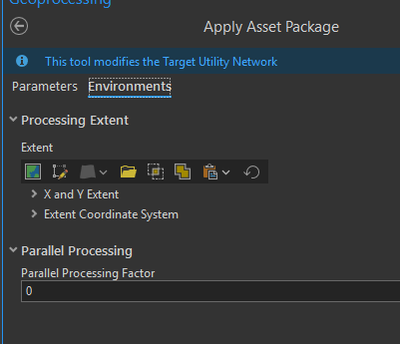

Thank you for the log.  I believe the parallel processing of append is failing for some reason.  Before running the tool, set the Parallel processing factor to 0

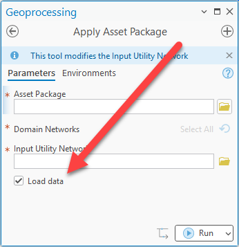

Please include a log from the apply asset package and make sure you have the "load data" box checked.
If you do need to manually append, set the field matching type to use field map. There are a few intentional field differences between the AP and a live utility network.
KokilaM
Please find the logs.

RobertKrisher
I don't see any append statement sin here. Is it possible you had the "Load Data" box unchecked?
Reeti_05
Hi @RobertKrisher , so am working along with Kokila on this. I can confirm the Load Data option and Calculate spatial extent options both were checked when we ran the tool
