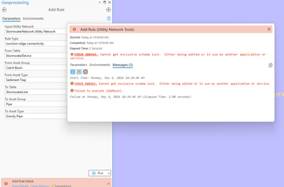

Hello, i have no idea what is going wrong when I try to add a rule to the utility network. I have editing turned off for all layers, so I know that's not the case. There are no other editors editing the data also. Any advice? thanks George.

Is this in an ArcGIS Enterprise environment? If so, services place schema locks on the dataset so you'll need to turn off the corresponding services (or disable schema locking and remember to restart the services after making changes).

If this is a network that you have "up and running", you have likely published it as a service so that you can access and edit it through the feature service. If this feature service is running, you won't be able to add or update any attribute rules until the service is suspended. Stop the service in Server Manager while you perform the update. You can manually break the locks to enable a quick change, but if you have active services, they will reacquire quickly.
