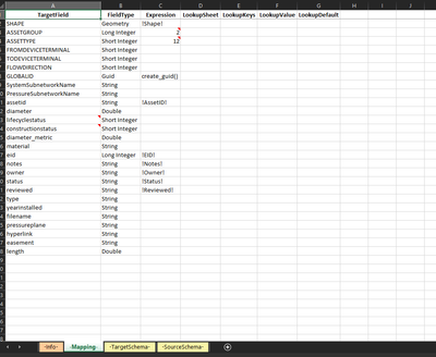

After I create the migration workspace using my own local data, I do not get the ACTIVE FLAG sheet in the 'mapping workbooks' created in the DataReference table.
However whenever I first went through this process using the dummy data, the ACTIVE FLAG sheet populated. So, I'm not sure where I went wrong when doing it using my local data.

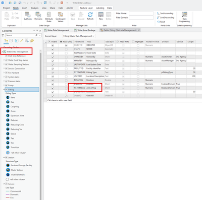

@TristanBest  - Don't think there is anything necessarily wrong here.
You are seeing the ACTIVEFLAG when you use the provided dataset because it is a field in that dataset.
You own local data might have that field called something else. You can use that field for mapping to the Lifecycle status following the same steps in the tutorial.

@gis_KIWI4 is correct. The data reference/mapping sheets generated by the tools are unique to your data. The tables, fields, and domains are based on your data, not the local government model used in the tutorial.

Ah I see, so I will need to create my own sheet in my mapping workbooks for setting the LookupSheet,Keys,Value,Etc for mapping the domain values for field expression conversions.
RobertKrisher
@TristanBest The tool will create the sheet based on your current model, and your job is to fill out the lookupsheet, keys, etc to show the tools how to translate your current data model to the target data model.
TristanBest
Hmm, I've tried a couple of times now but when I create the data reference table, the supporting mapping workbooks do not create the sheets. Not sure what I'm missing to cause this.
