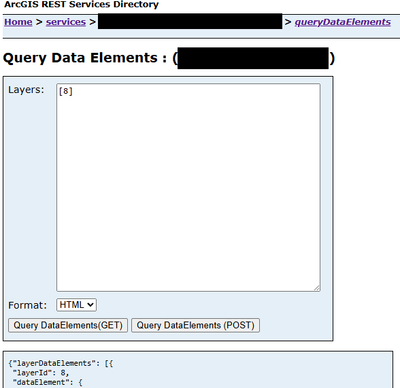

gis_KIWI4
MVP Regular Contributor
@RobertKrisher Thanks for confirming that. Can I ask a question on how to query the UN Data Element via REST? I keep getting the error.
Were you suggesting I do it a different way - Like ArcPy and Describe()?
RobertKrisher
There are many different ways to get this information, depending on which API you're using (arcpy.Describe for ArcPy, getDefinition for Pro SDK, etc). In a services-based environment it all ends up in a call to get the schema/definition from the FeatureServer/queryDataElements operation. You can do this manually by passing in the layer id of your utility network. This is the REST endpoint equivalent of Arcpy.Describe.
gis_KIWI4
@RobertKrisher - That's exactly what I was looking for! Didn't realize queryDataElements was an option, I conveniently glanced over this section in the API Reference.
