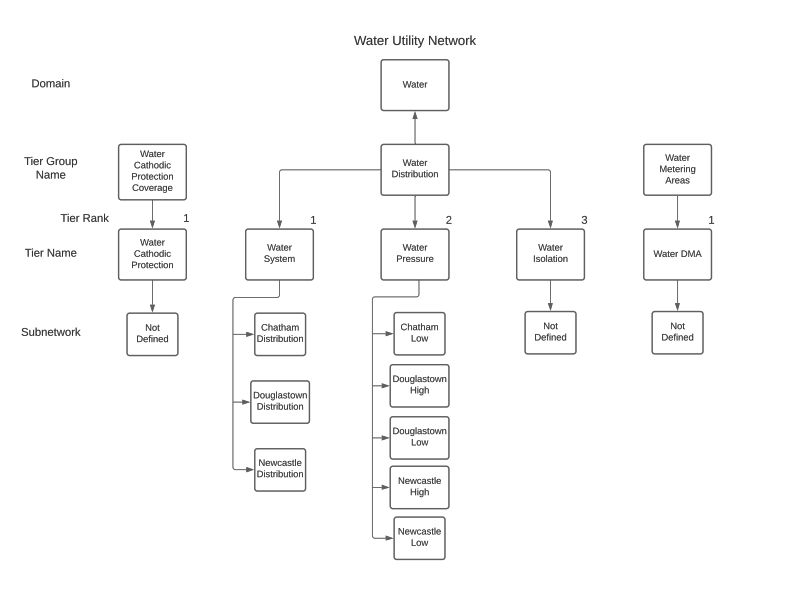

Also handy would be a visual way to look at the network Tiers, see the attached for ours.Water Distribution Network Tiers.jpg

As of ArcGIS Pro 3.2 you can use the Generate Schema Report tool to create an excel or html report for your geodatabase. This includes a section that describes the tiers in your network.
You can also use the utility network properties extractor to produce this in csv format.
If you want to visualize your actual subnetworks, you can use the export subnetwork controllers tool to output all your subnetwork controllers to a csv file (that includes tiers) and use that to generate a graphic like what you referenced above.
