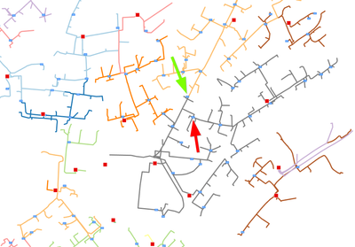

Yet, coloring the many thousand subnet lines (coloring by subnetwork name, what else can I do)) we get this warning:
Well, I have to click Yes to have some sort of useful coloring.
Besides likely not being nice to performance having coloring based on a very large number of unique values, we also quickly see the problem: Adjacent subnetworks (subnet lines) are assigned colors very alike (or perhaps the same).
In the screen dump below, the green arrow indicates a place where adjacent subnetworks are assigned contrasting colors whereas at the red arrow two adjacent subnetworks are assigned the same color:
My propsal to Esri is, that when updating subnetworks, you also assign a coloring-number to each subnetwork (an extra attribute to be added). Not a color code (#3380ff) - just a number from 1 and up. Then I may choose whether 1 is represented by red, green, ...

We have similar scenarios in our gas network with Isolation Subnetworks. (Although we merely have thousands, not tens of thousands to deal with). I appreciate @Jens_Dalsgaard suggestions for generating a set of colors that are non-adjacent.  However, I am also interested in maintaining stable color assignments to the same networks over time.
Since subnetworks are split or added one by one over time, a small number of subnetworks have colors assigned or adjusted after the initial colors are assigned.
The way we have approached this is to add a color field to the subnetline featureclass but also maintain a separate table with the subnetworkname, tiername, and color. This table is editable. There is an attribute rule in the subnetline.color attribute to copy it from the separate table if the subnetline row is updated or created.
This allows us to generate colors using python or whatever we like but also to manually adjust or add if someone finds a color that was generated to be not optimal.  This is all because the subnetline is not directly editable.
Note that we don't have a good user interface for editing this table at present. If Esri were to implement this solution, I would expect that would be part of the need - a way for users to pick the colors they want or to calculate or recalculate a color for all the subnet lines or a portion of them - whether this was on the subnet line or in a standalone lookup table.
