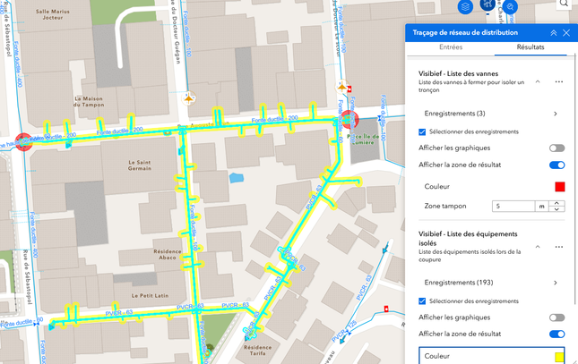

PierreloupDucroix
I agree.
In this same scenario, we ended up running two traces simultaneously in Experience Builder, and the user can assign different colors to identify the equipment or print the map. Obviously, this solution doesn't work with Field Maps.
two trace results with different colorstwo trace results with different colors
But the ultimate goal is to export a list of all the equipments indicating whether a valve needs to be operated or not to perform the leak repair. Therefore, it would be very useful to have an "isolating_feature" flag in the trace's response JSON, so they can be easily identified, whether through map rendering or attribute processing. All this without having to reprocess the trace with the JSON file.
