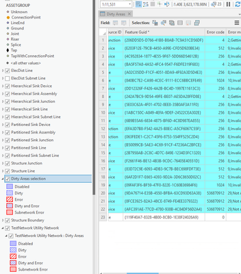

To determine within Pro, what these counts are - for errors and subnetwork errors.  Open the Dirty Areas table, and do a query:  Select by Attributes  where Error Code Is not equal to 0 (ERRORCODE <> 0 [in SQL]) - this will give you all of the dirty areas which are associated with errors of some sort.

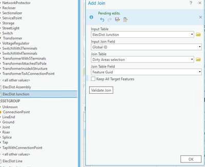

First do the above selection on the Dirty Areas table.  Right click -> Selection -> Create Layer from Selection.
Now you have a layer 'Dirty Area selection' -- which is only the error features. Next create a join for the class you are interested in cleaning up (Junction, GlobalID) join to:  (Dirty Areas, Feature Guid).  Uncheck the box to keep all target features.
And you will be left with a junction class (in my example), which contains only the features that have associated errors that need to be addressed (2 features in my example).
