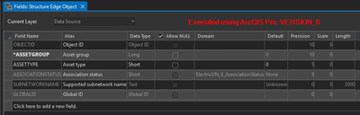

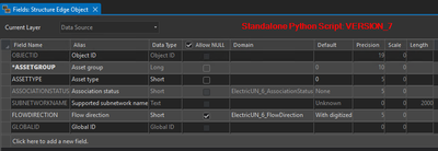

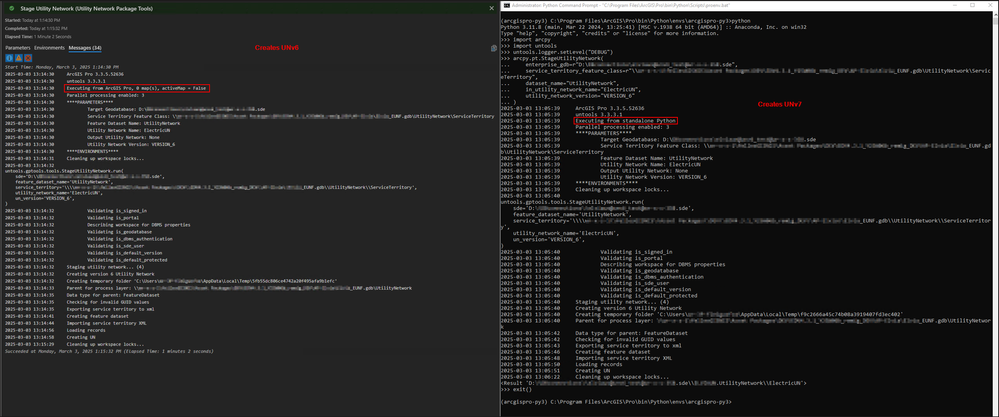

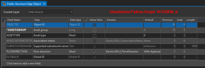

Hi @PaulLeBlanc1 . I'm having issues using untools 3.3.3.1 to stage a utility network with the correct UN version. I'm trying to create a UNv6. Works fine when running inside of ArcGIS Pro, but when running as a standalone python script it creats a UNv7 even though the logging seems to be correct.
I have tested running StageUtilityNetwork as a GPtool, as a notebook and in the python window in ArcGIS Pro 3.3.5 wich results in the correct UN version. But as a standalone it always creates an UNv7.
TomEriksen_3-1741007502995.pngTomEriksen_4-1741007513472.pngTomEriksen_5-1741007521370.png
PaulLeBlanc1
@TomEriksencan you try from an non-elevated python command prompt? Internally, the tool is writing to the registry so that might explain it.

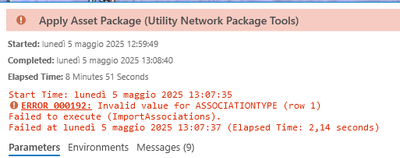

im on pro 3.3.5 + un tools 3.3.3.1. When I try to apply assetpackage to file geodb (empty un v7) the following error appears:
The issue is related to how the CSV was generated by the tool during execution (AP_Workspace0\csv\association001.csv). The tool creates a CSV file using a comma as the separator instead of a semicolon, which is what the import tool expects. Is there a parameter in PRO  "or elsewhere that can be changed?
PaulLeBlanc1
@gpgisandsky I've not been able to reproduce that behavior, but I believe it should be resolved with 3.3.4
