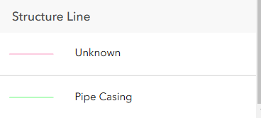

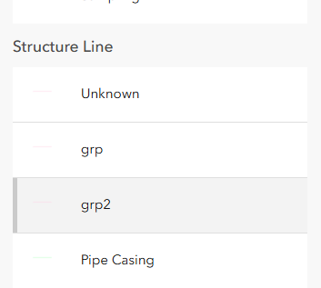

Following the steps outlined in the blog/article, I was able to download the necessary plugin, save templates, and publish as a feature service. However, upon publishing, I encountered error 24801, which indicates that group templates are not supported.
After publishing, the group template is not visible in the Web Map Viewer, though it does appear in the Web Editor app. Unfortunately, attempts to edit in the Web Editor result in an "editing failed" error. I've attached screenshots for reference.
This issue occurs in an ArcGIS Enterprise 11.3 environment and has been tested with both branch versioning and standard feature services, yielding the same result in both cases.
Any suggestions?

LisaStanners
The blog mentions "In the future, support for these editing templates in the database will include ArcGIS Maps SDK for JavaScript, Experience Builder, Map Viewer, Scene Viewer, Field Maps, and other applications as appropriate."
The Map Viewer not seeing the group templates is expected, but the web editor I believe should be able to use them. I will need to get that looked into and report back. Thanks!
LarryYoung
Yes, Web Editor can use shared templates (templates in the database) today.  The plan for the other web applications is to add support in 2025.  Pro 3.5 will be needed in order to write templates to an Online database, so hopefully the capabilities for other apps will be available with Enterprise 11.5 and the Online release around the same time.

Hi @ArunkumarV
I had the same error but I managed to find solution. At first I follow instructions and created group templates using direct connection to database (branch version), stored templates in geodatabase using add-in and then I've published new web map. When I opened published web map in Web Editor I experienced the same error as you. I'm working with utility network dataset.
My solution/workaround was to remove all group templates from my map in ArcGIS Pro and share web map with configured utility network but without group templates. After sharing web map, I created again few group templates using map from which I shared web map with utility network and stored them in geodatabase using add-in. I opened Web Editor again with previously published web map and templates are there and they work. I've created user connections with service meters from group template without any errors.
So, my workflow was first to publish web map, and then to create group templates and store them in the geodatabase. After storing templates in geodatabase, they are visible in Web Editor through web map that contains feature layers published from branch versioned datasets.
This workaround solved the problem for me. Hopefully it can be useful for you too.
