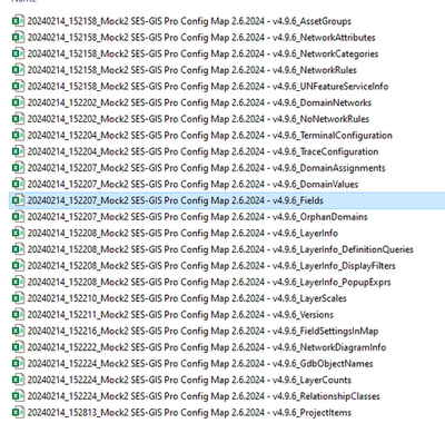

Thank you for this tool, it is awesome! But, for some reason, I am not able to extract Contingent Values. I have tried the Extract All and the Contingent Values, each, no results. Any Ideas? When I ran the Contingent Values, a window did come up showing export to the folder sub of ProSdk_CSV, but nothing actually gets exported. I am on 2.9.10.
The Extract All yielded the below outputs:

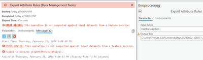

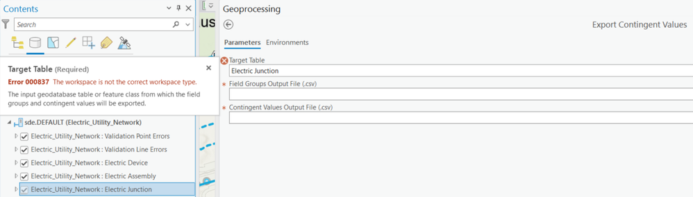

The Contingent Values and Attribute Rules buttons will only generate CSVs if the layers/tables in the map are from a database connection (file, enterprise, mobile).
The Contingent Values button calls GP Tool, Export Contingent Values.  The error in screenshot is when the "target table" is from a featureservice.
The Attribute Rules button calls GP Tool, Export Attribute Rules.  The following error message is raised when the input table is from a Featureservice.
